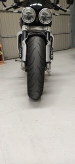

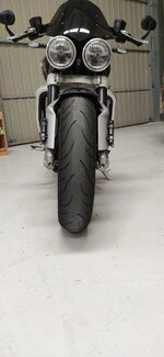

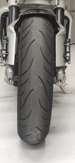

Hi fellas, first of all sorry for my English, it's not my first language and probably there will be a lot of mistakes!
I have a doubt.:
Is it possible that the front wheel of our motorcycle is not centered with respect to its longitudinal axis?
Because I appreciate a deviation. A big one, and I've never touched anything in the front wheel.

The guys are correct. The front wheel is slightly offset to because of the triple cylinder/shaft drive configuration to allow it to track straight while driving.

Yes correct, I took this up with the dealer how the top of the range Triumph can not have the front guard not centred with the wheel, they said all are like this and due to the reasons in this thread, still I think Triumph could have cosmetically fixed this very easily...
