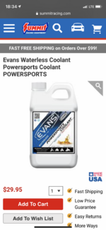

I use the evans waterless coolant, nothing different can be added to it, it has helped with temps Not rising.
Maybe when I'm as hopped up as you!! Until then I'm trying to stick to something a little more common in case I need to top off somewhere for some reason.
Yeah i have to carry a little just in case. It does help though, bike makes most horsepower at 85cel and evans holds at 91c 92c we found out on last tune. If we could keep it at 85c we could get all them horses
