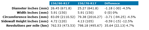

Opted for a Bridgestone BT021 150/70R17 (69W)
On paper the rolling radius equates to a 140/75 and 4.5% less than the 150/80 OEM
imo it´s a light "pinch fit" but nowhere near as pinched as the OEM 150/80 Metzler front. Will fit tomorrow.
