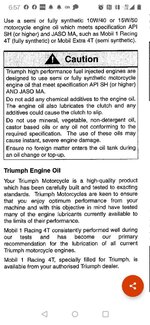

Did you recently change the oil and put regular synthetic oil in it??? If it's not 4T see attached. It will ruin the clutch plate material and you will have to change the clutch and oil. Hope not, but if you change the clutch put stiffer springs in it, a little harder to pull but less chance of slipping. GL but I would definitely take it back to the dealership, the worst they can do is say no it's been modified and charge you a shop fee, tell them you want an estimate before they do the work, I think they always ask you if you want them to do anything, I know I had my tires replaced $900 they were off by $200, they were supposed to charge $150 for the installation on a verbal quote and charged $350 👎😕 and in the middle asked me if I wanted the brakes done for $350, they were shot, I did them myself for $30 aftermarket pads from eBay, not the greatest pads but if I don't like them I'll get better one's, I already have the front on, they were past the wear out warning, back's not as bad, doing this weekend, but the fronts work great, I even changed the fluid, very easy!!!👍👌 The clutch you can do but a lot more work, have to take off the radiator and they recommend the front wheel, and make sure you torque them even and right, the bolts are made to break under too much pressure. But definitely go with plan A first!!!👍👌

Because the clutch grabs when cool, it could very well be the oil.. Unless u used specific bike oil that has no friction modifiers in it, when hot it will slip when the modifiers
release from the heat.. Using 20w-50 also helps with clutch issues as the oil stays just a little thicker when hot, just make sure its bike specific. My neighbor used Mobil One
extended life synthetic in his T-120.. The clutch did the same thing as yours.. He changed it out with Mobil One 20-50 motorcycle oil, and the clutch came back in just a few miles.
