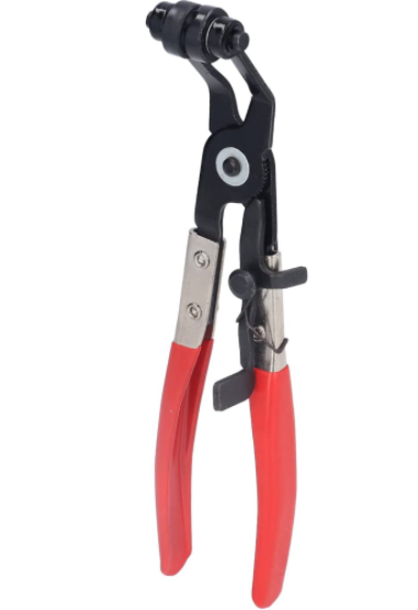

you can not work on that hose clamp without this EXACT SAME hose clamp tool( good luck otherwise), use this hose clamp tool and then push the hose in with a flat head screwdriver or if you have something better other than screwdriver
