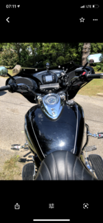

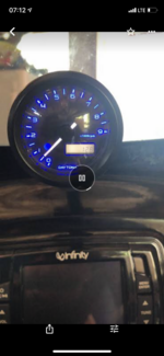

Side note: anyone have an aftermarket tach that they I stalled and liked? It feels weird not having one on the touring (especially given that I'm more rpm cautious now on the Carpenter setup.

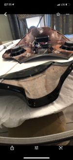

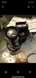

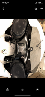

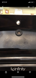

Tach install, shift light and volt meter, programable, nice unit
