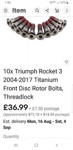

You can buy titanium bolts for your rotors, bought mine from England.

Cool next time I'm in England I'll pick a few up 🙂😁 I looked all over online and they didn't show up, good day lad thanks, I'll look for a tool but sounds easier just connecting up to the rail and doing them all, everytime I mess around the TB's I drop something behind them and can't get it out, I'm getting smarter and stuffing rags in between them. Thanks for your quick reply though brother 😉
They on ebay too

10x Triumph Rocket 3 2004-2017 Bronze Titanium Front Disc Rotor Bolts Threadlock | eBay Thanks I guess I didn't do a search on eBay, can get it cheaper yet from China but I'd rather get from UK Thanks, I already got used one's on the way and I won't have to replace them all cause they will match, but titanium sounds good, 1/2 the weight and 10x stronger than regular steel. I'm on 5 bolt's in the rear out of six now, so I'll be putting that baby in right away. TY ☺️

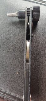

Got a great right angle bit wrench from harbor freight probably about $4.
