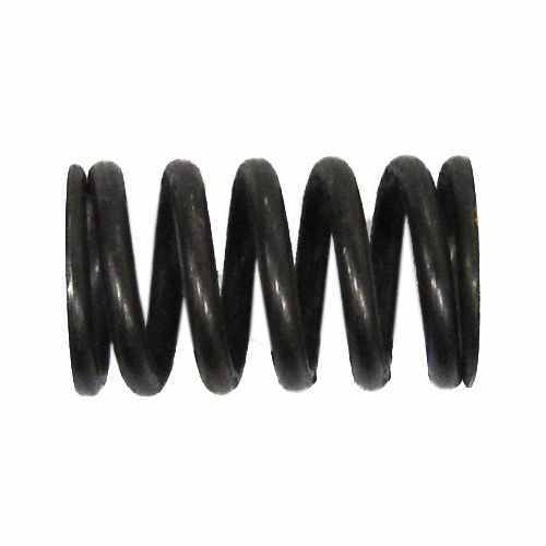

I think I remember posts a few years ago referencing Suzuki Hyabusa clutch springs being very strong upgrades for Rockets and of a par or better than Barnetts HD ones.
The stock Triumph ones were not very impressive apparently and the common aftermarket clutch kit providers were not much if any stronger at all.
I think Neville did some measurements. I'll have a search.............But anyway
Seems very cheap especially with free shipping from UK.
For Suzuki Clutch Spring Kit Gsx 1300 R-K1 Hayabusa 1St Gen 2001
Clutch Spring Heavy Duty

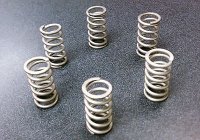

SET OF SCHNITZ ULTIMATE CLUTCH SPRINGS FOR BUSA
If your clutch is slipping jerks when you run it hard on the street or at the drag strip, these are what you need !!!
PART NUMBER: HAY1014 ( AS SHOWN IN PHOTO SLOT #1 )
FITS THE FOLLOWING APPLICATIONS:
1999 2000 2001 2002 2003 2004 2005 2006 2007 SUZUKI GSX1300R HAYABUSA
THESE SPRINGS INSTALL AT 40 POUNDS OF PRESSURE MEASURED AT 1.00"
NO SHIMMING OF THESE SPRINGS REQUIRED!!
This is a race part - - - care must be taken while getting used to how your clutch feels as you get used to it.
These heavy-duty clutch springs are a must for any kind of performance riding !!
DON'T HESITATE TO CONTACT ME FOR A QUOTE ON ANY APE PRODUCT - - CHANCES ARE I CAN SAVE YOU SOME MONEY WITH MY OTHER EBAY LISTINGS !!

I have the springs in a new complete Barnetts Clutch kit and was going to use them.
I don't think I will be draggin' much if at all.
I was advised recently that the Barnetts clutches and springs are good for 300HP anyway.;):cool:
