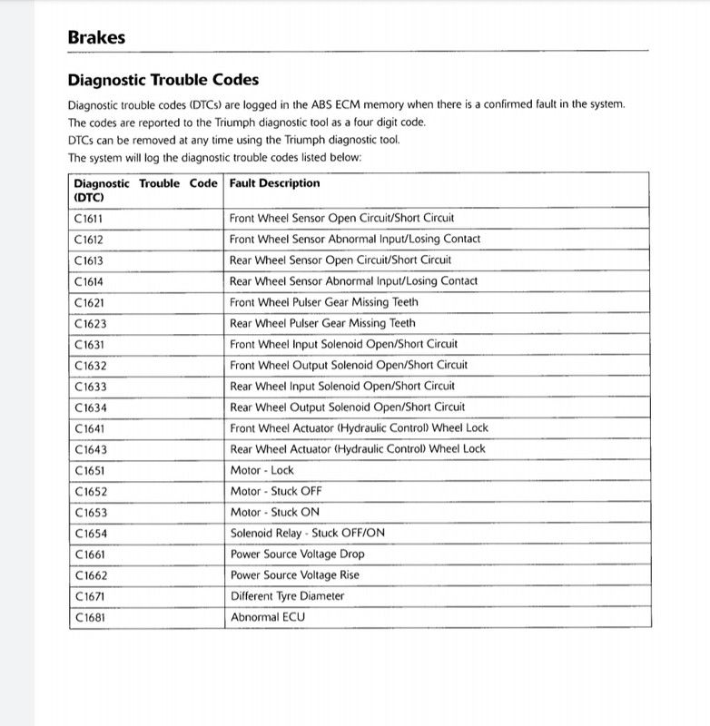

A list of what causes the ABS light to stay on;
