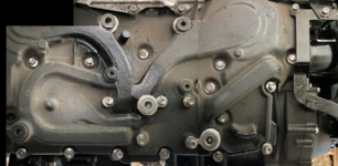

Maybe it's just me, but the diagram of the drain bolts in the manual makes me dizzy. With the lean of the bike you'll probably want to work from the right side. Here's the original ...
Here it is rotated which, for me anyway, reads easier. If you're laying down on the right side of the bike and look up- this is what you'll see, with the front of the bike to your right.
and a badly stitched together photo of the same....
Btw, all the drain bolts are 8mm hex- the smaller sized hex bolts are not what you want to remove.
